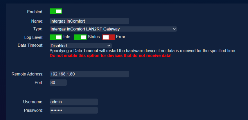

Navigate to Settings -> Hardware
Choose "Intergas InComfort LAN2RF Gateway" as Type and fill in the appropriate fields:
  • Name For example, type "Intergas InComfort"
  • Data Timeout: "Disabled".
  • Remote address: IP address of the LAN2RF Gateway.
  • Port: default: 80
  • username: admin
  • password: The password that is shown on the back of your gateway. (which you can change via the web interface if you point your browser at the IP address of the gateway)
Once Domoticz has successfully established contact with the gateway, it will automatically create all devices.

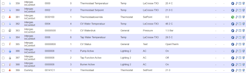

Under menu Settings -> Devices, there are now 10 new devices. Click on the green arrows to add the devices to your overview.
You can then adjust the names to what makes sense to you (as has already been done below)
After this, you can simply operate the thermostat (the setpoint device)
The setpoint device is sometimes set to 0 by the real thermostat or the app, which makes it unusable in domoticz.
  • So set Thermostat override to NOT ACTIVE (see the green arrow behind the device)
  • For this, create a dummy thermostat device and call it Thermostat.
This will be a dummy thermostat setpoint device (see picture above)
  • Rename the original SetPoint device 0030100 (in my case device 361) to Thermostat override
  • Rename Temp device 0002 (in my case device 360) to Thermostat Setpoint
  • Activate the DZvents scripts
Now you can use device Thermostat in Domoticz as Thermostat.
Thermostat Setpoint indicates what the real physical thermostat (slide on the wall) is set to
Thermostat override is not used because it is sometimes set to 0. Again, remove this from the active list by setting the arrow to green
